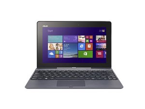

I did a fresh install of Windows 10 on an Asus T100TA hybrid device, which i've done a couple times before without issue, but this time i have the error "No audio Output Device is installed". The Realtek drivers are installed and i've tried different versions, going back to Windows 8 which this device came with. All install ok. The issue seems to be the Intel SOC/SST Audio driver. This fails to install and when i manually try to install by pointing device manager at the folder with the .inf file it blue screens with error SYSTEM_THREAD_EXCEPTION_NOT_HANDLED. I tried suggested methods of using an Lenovo Thinkpad 8 version of the SOC drivers but that gives the same error.
I have tried installing drivers with SDIO too.
Any ideas how i can get audio working on this device again?
