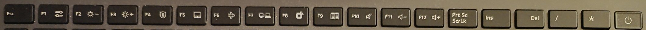

Windows 11 supports what's called a Secure Mode where the camera and microphone(s) are disabled. There should be an icon in the system tray (possibly overflow area) that indicates whether it's on or off and it looks like a shield with a key hole in the middle. That being said, on some machines this does not show up.
It's also generally shown as a function of the F4 key, with an icon that matches what should show up on the system tray.
If you don't have this icon in the system tray, I suggest you open up Settings, Bluetooth and Devices, Cameras then looking at whether your camera is even listed there. If it's not, try hitting Fn + F4 and see if it suddenly appears and that camera icon suddenly comes to life. If Fn + F4 doesn't work, then give naked F4 a try.
It's possible that the Secure Mode function may be associated with a different function key, but I do know the shield with key hole icon is consistent, so look for that.

Just FYI, here's the function key row on my laptop. The Secure Mode Icon I was referring to can be seen next to F4 on that key:
