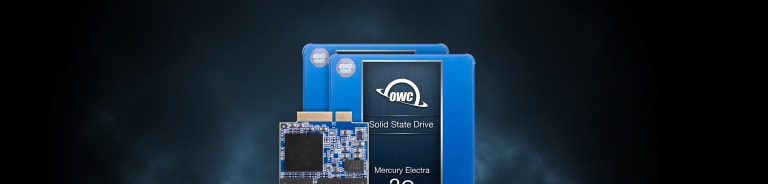

I'm just working on this in my downtime. I'm not charging by the hour because if I did, they might as well buy a brand new one. I'm not a Mac guy but this is giving me valuable experience. I know a mac guy but he is super busy right now. Anyways, I'm pretty sure it's the drive. I'm going to order another one but need to know exactly what to get. Someone mentioned OWC?

I did click the link. In it there are links for a few operating systems but not for Mavericks. If I download and install one of them will it wipe the data off the drive as it would with windows? I have a time machine backup on a drive, but I want to be careful. Also, the only reason I'd be downloading and installing a new OS onto the old drive is to prep the macbook to use the new drive as I read this on a page for a drive I found: "
  • Must update original SSD to macOS 10.13 or later version before moving out. New SSD will not be recognized after replacement if original SSD installed 10.12 or earlier Mac OS."
