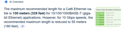

TBH ... If you can get someone to do it for relatively cheap .... that might be the best option since the distance is so short.
Or if you want to really cheap out grab a shovel and trench a Cat6 Cable ... get some outdoor rated, gel filled Cat6 and bury that sucker in the dirt or if you are feeling spicy throw it in some PVC conduit.
