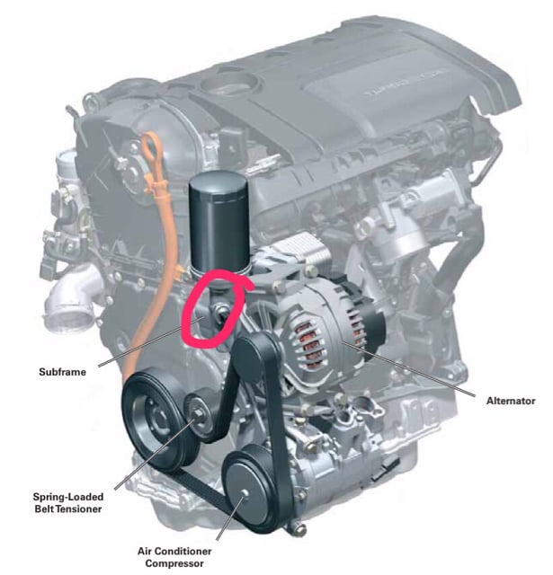

For the most part I enjoy automotive wrenching but as the years go by I don't like going under the car any more. About the only thing is the oil drain as now VW has even put the oil filter up top on their 2.0L turbo petrol engines. You can unscrew/remove it and it doesn't leak a drop of oil even when faced straight down. I'm impressed.......
