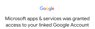

BTW, today when I "flipped the switch" in Outlook 365 desktop to try the "New Outlook" I got something for my Google Account that's been in use by Outlook Desktop forever that I have never received when I've flipped in the past:
I've had to go through the OAUTH process in the distant past when the account was initially configured in Outlook, but have never been asked again since. Something's changed "under the hood" where the New Outlook is no longer recognized as having access, even when it did in the past.
Flipping back to Outlook desktop did not trigger any additional OAUTH activity.
