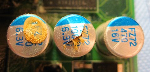

They do go bad, especially if they're from around the 2002-2006 vintage where capacitor plague was common because of bad chemistry in a few big factories.
I saw an XFX 6600GT with so many bad caps it made my head spin. I don't know how it lasted for as long as it did.
All but a few looked like that.
All capacitors can go bad and they don't have to swell or leak to do so (but often times they do swell or leak).
