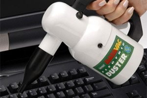

Data Vac in action
The DataVac in action on a customer PC at our office. It does have a cord which reduces mobility, but makes up for this limitation by providing a much shorter, and more powerful, cleaning experience compared to compressed air.
The device comes with a few different nozzle options, but to be honest, the one we use nearly weekly in the field is the cone with the thicker neck. This seems to be the perfect nozzle for clearing large amounts of computer dust out of systems in a fast manner. We don’t even take it off when it goes into our toolbags; we leave the nozzle on, and merely use a cable tie or rubber band to keep the cord tidy.
There is a power button the DataVac which controls operation, either on or off, with no other options. Very simple but it doesn’t need anything more. The DataVac also has nice rubber feet you can stand it on, which is better than placing its otherwise full-metal body onto wood furniture or flooring at customer sites.
One thing you should know is that the intake area of the DataVac at the bottom of the unit WILL get full of dust, and to a greater extent the more you are dusting in tight areas with poor ventilation. This is because you guessed it: that same dust you are blowing out of machines is just being sucked back into the unit. I was worried that this was a bad thing at first, but there is a very nice dust filter that covers the intake which you merely need to clean on a consistent basis. I tend to check it before any dusting I handle, and for bad dustings, tend to wipe it clean every 2-3 minutes.
The unit works off wall power which means it doesn’t have to be shut off to recharge, and it has a consistent strong airflow. We can usually dust out a full PC in perhaps 30-45 seconds, and servers with more intricate crevices in about 1-2 minutes. The device works wonders on dusty routers, network gear, racks, and many other IT items too.

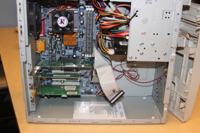

Cleaned by Data Vac
The above PC was downright filthy when we got it into the office. This photo shows just how clean the DataVac got it – to the point where the original stickers inside the case shimmer.
