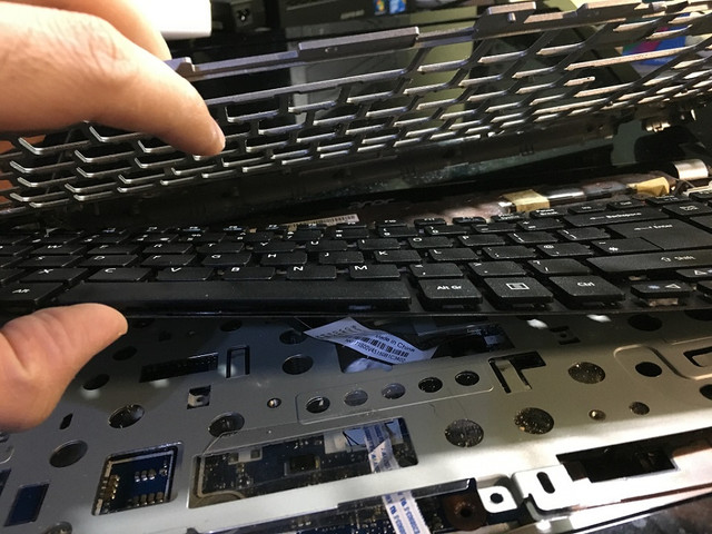

Keyboard replacement on Acer V3-571G!!!
3 layers: some metal plate above the motherboard, then keyboard, then plastic plate. The plastic plate has the ribbon cable for the power button that is attached to the metal plate (which obviousy is connected to the motherboard). Keyboard cable has to somehow get through a tiny hole in the metal plate to connect to motherboard (leaving on 2 inches to work with).
