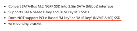

Client wants me to retrieve data on the drive. Earlier this year I purchased this m2 driver holder just for situations like this: https://www.newegg.com/en-labs-m2ngff25satabr/p/35G-008B-00009?Item=9SIACJF8369237
Drive doesn't fit into the slots - it's just a tiny bit off. This is not my area of expertise - I thought a 2280 m.2 was a 2280 m.2. So - I need to get data off drive, not an expert on this stuff, thinking I should actually just buy her an enclosure so I can give her the drive back out of the system to access data anywhere. Looking at this list on Amazon https://www.amazon.com/s?k=m2+2280+enclosure&i=electronics&ref=nb_sb_noss_1 - anybody know which one I should get?

NVME drives are different and will not fit the other adapter. Other drives will not fit an NVME adapter in turn.
The one I linked will work.
