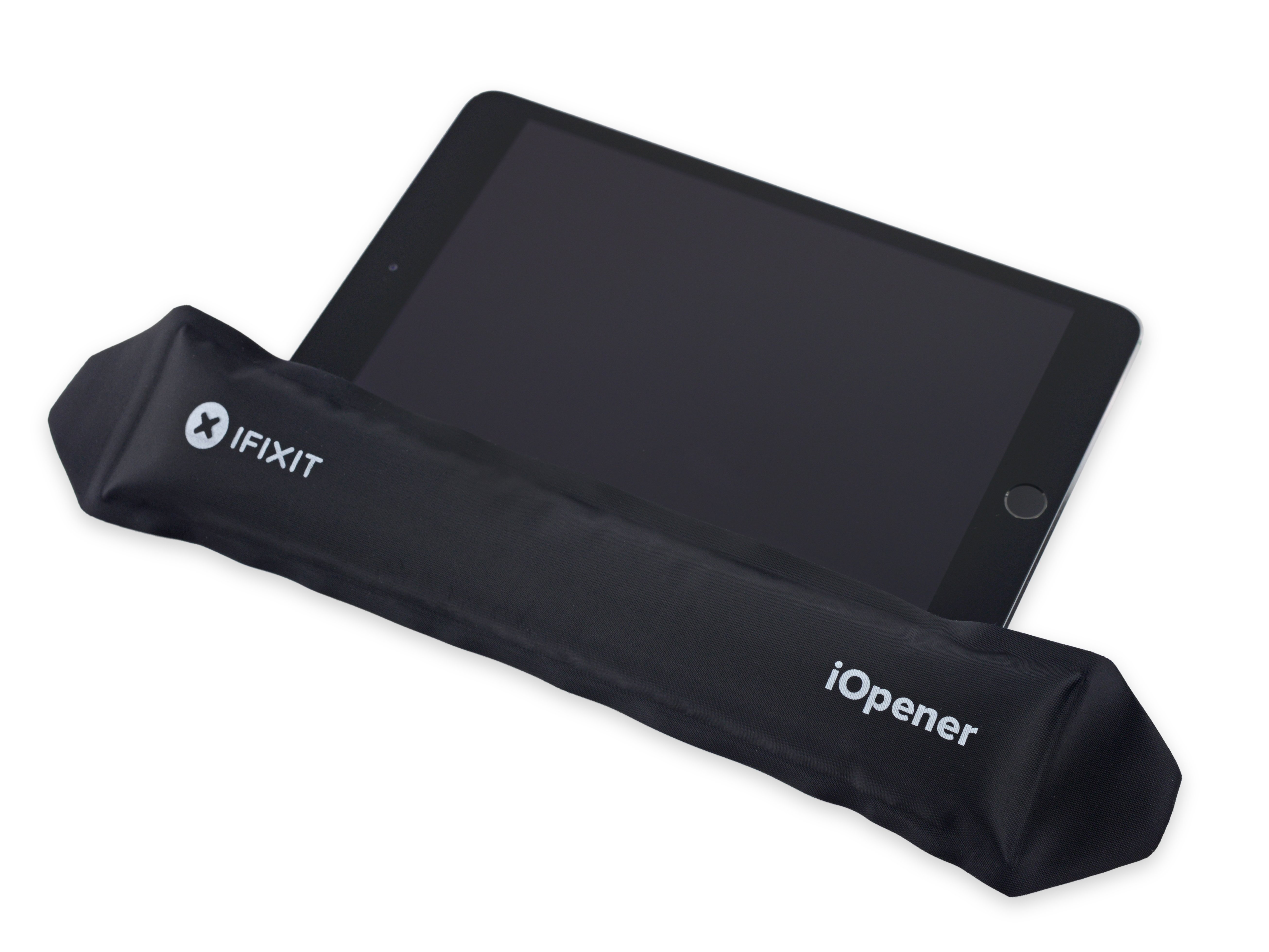

Use tape on the screen, will stop the glass shards from going everywhere. There are heat pads, used to warm and loosen glue from panels.
I have the iOpener :)
