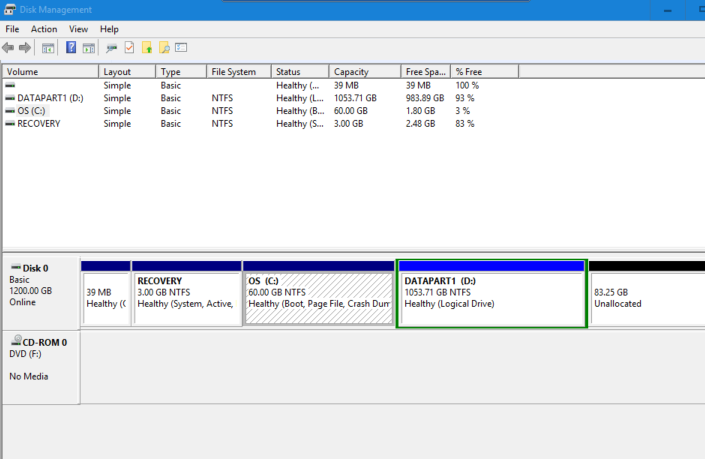

The server at one of my top clients ran out of space on drive C today. I've done what I quickly can to free up space and get things moving. But I need to go deeper and / or make more space. Unfortunately the C volume is only 60GB, Windows Server 2016. Has not been a problem until today.
We have a RAID10 array of SSDs making a 1.2TB volume.
I'm barely using any of the space on the 1TB partition. Have 86GB free on the end.
I'm thinking I can shrink the 1TB partition, but it needs to move over. Seem to recall doing something similar in the past and it not working.
Any suggestions?

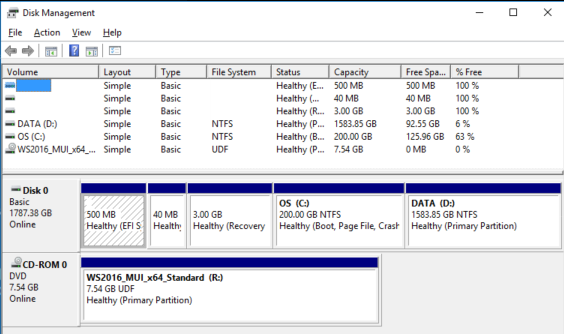

Didn't mention that the server is a Hyper-V VM. Here is the Disk Management of it's Hyper-V host:

That's what I'm talking about in the original post, I think. Same problem will result I'm afraid as the boundary for the D partition will block the C partition from expanding. The volume is already big enough, there's an additional 80GB unallocated at the end.
Ah yeah that's right..and funny thing is I understood that in the original post. Too many shiny lights today. Contiguous partition.
