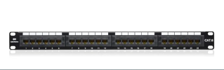

Vertical racks are fine if you have a top cover. Even a relatively clean space can quickly build up debris. What else is in the rack beyond the PP and switch? If that's it then just mount the switch flush to the back board, rotated so the ports are vertical, and use a couple of these for patch panels. See that all the time small retail outlets.
