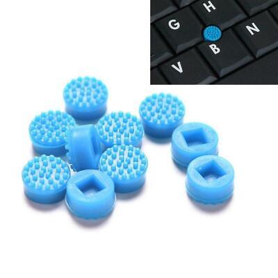

Hi,
I am doing computer rental and frequently some laptops are returned without the keyboard trackpoint cap.
For good, long-standing customer, I simply cannot invoice that.
So, I decided gluing the trackpoint caps, in a way that I can still replace them (with some effort), but so that they are somewhat harder to steal for fun.
I have tried contact glue (applied 5 minutes on both sides) and it is not gluing well.
I also tried cyanoacrylate glue (instant glue / superglue). Seems to stick better, but still disapointing.
So, my question is what kind of glue would be nice for that?
Preferably do not mention a brand, as it may not be available in my country, but rather the kind of glue.
Thank you.
Unfortunately, I can't tell you a glue type, per se, but several brands (at least one of which is probably available internationally) you might try.
First, some notes: Cyanoacrylate (AKA super glue) is a horrible choice for anything where a "perfect fit" between the surfaces being joined is not present, and that's definitely the case for these rubber caps and the plastic bit they are to stick to.
Epoxy glue (5-minute, preferably) in a very tiny amount might work, or it might not. It will certainly get things set up initially and at least "for a while" but I suspect that the rubber cap will slowly, and over time, come loose because it stretches and deforms during use, but epoxy does not have that capability.
Thus, my favorites for this would be either Shoe Goo or E6000, both of which are glues which set very much like rubber. They have very strong grip on the surfaces joined, and can themselves deform/stretch and spring back into their "original configuration" because that's what they're meant to do. These are the two products I generally use for purposes where a long term, flexible bond is required. I do not know what one would call either one of these generically.

The problem is when, mind you not if, the mouse stick cap needs to be replaced you don't want to spend hours on it. Might want to look at a very thin double face tape.

I have little tubes of 5 min epoxy for when I need a good bond, but I also have a bottle of UV Resin which for some applications works surprisingly well. The UV Resin was cheap, like 100ml for $13 which for what I typically use it for lasts forever.
Thank you for your suggestions.
I was not aware about the E6000.
I used SUXUN T-7000, which is a black epoxy glue, because this is what I had it on hand and it is easy to apply.

Just source a bunch of spare trackpoints for the brand(s) you rent out.
E.g. 10 x Dell compatible trackpoints for AU$2.40 including shipping (from China).
I had placed a similar order to replace the lost trackpoints.
