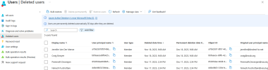

The weird thing about this one is that they purchased 3 domains through their tenant through M365, using my clients saved payment info then created users, then deleted the users. So the users are now sitting in the deleted users section. (vacalug.net and swuk.org are the other two).
They changed some contact info in azure.

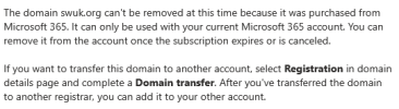

When I try to delete the domain out of the tenant I get:

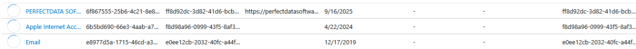

When I go into the billing section for the purchase there is no option to cancel the subscription ... only to disable recurring billing:
