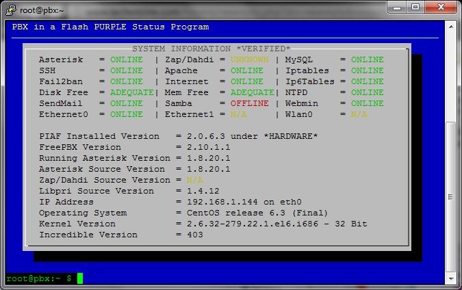

Installed PBX in a Flash (Purple) on an old Dell I had lying around... Also tried installing Incredible PBX, but I honestly don't even know if that worked or not, lol. At this point, I'm looking at the PIAF status program. I created a dedicated GV account to use for the DID... not sure how to configure it in PIAF though.
Anyone care to point me in the right direction? I'm not a complete Linux noob... I aced both classes I took on Linux, but that was a couple years ago, so I'm pretty rusty.
Start over download PiaF green once you have the base PaiF installed, install iPBX, if your will using this from remote end points (out of your office) install Travelin' Man 3. Once you have that done go to connectivity and look for google or motif add your google account there
I only recommend PiaF 2.0.6.3green because the developers recommend this version for business and production setups.
Well I've already gotten the purple install configured supposedly... we'll know for sure once I finish installing this softphone and make a test call.
I'll do a green install on another box (or VM) when I'm done with this so I can see what the differences are.
I run my business of a VM install of PIAF Purple... rock solid.
Doc, setting up a GV trunk takes all of about 15 seconds. Have a look at the Nerd Vittles article on it.
