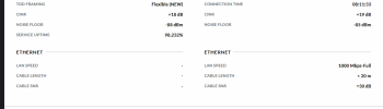

first of all, looks like an issue between the NanoStation and the switch, below is the Ethernet Report (left is Nano). Not sure why the Dlink is shown a link light, might be something to do with the PoE then. Will go out and check that.

That is most likely a bad cable. Check and re-crimp the ends or use a new cable. If that doesn't work try a new POE. Is this a Nanostation 5AC Loco? In the US they never come with a POE included so is this the correct POE for the device? How long is the cable? A good cable should give you an estimated length.
Yep, tried different cables, now tried different PoE and also a different switch and nothing seems to be making a difference.
PoE's were purchased with the Nanostations and what was recommended so they should be fine.
