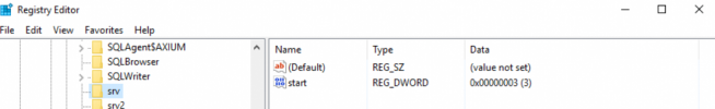

The key for LanmanServer is:
and the key for "srv" is:

So now "HKLM\SYSTEM\CurrentControlSet\Services\Srv" is almost empty
and "HKLM\SYSTEM\CurrentControlSet\Services\Srv2" is complete.
As you said, it makes sense. Something went wrong when SMB v1 was disabled.
