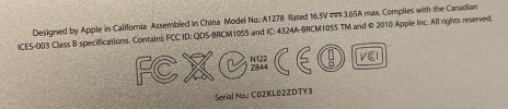

Thanks. I've now asked for a photo of the make/model sticker on the charger itself (or both) and the underside of the Macbook. I think that Apple puts make/model on the underside of the Macbook, but it's been so long since I've looked I don't know.
The client responded and says it's a 2012 Macbook Pro that she's had for a few years now (obviously). She sent the photos as I was typing:
That ought to cover any questions about the specifics.
