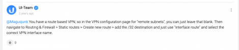

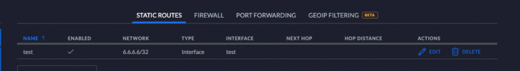

Just got back and checked that thread you linked to @timeshifter. I was able to create a IPSEC site to site with no remote subnet and then add a static route with an IP/32 entry. Of course I don't have any time to test it but it looks like that concept should work.

Thanks Mark! I feel pretty good that using a static route may solve the problem of the remote subnet. However, revisiting the other issue, I wonder if this is the final nail in the coffin as @HCHTech alluded to.
