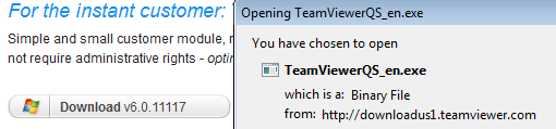

TeamViewerQS_en.exe [I] (default file name)[/I]

I have TeamViewer buttons on my website and the quick support downloads "TeamViewerQS.exe" there is no reference to language which I assume "_en" means english. Do you get the TeamViewerQS_en.exe when you download it? I wonder if it has anything to do with being in different countries maybe?

The TeamviewerQS_en.exe is right from TV's download page:

Very interesting I tried it from their site and I got what you got, with the _en I wonder why when I used their website to create buttons for my website I get a different version. Oh well that is for another thread as well.
