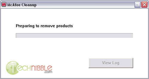

Enter the McAfee Consumer Product Removal Tool. This tool will remove the following McAfree Products:

Before using this tool, always try and remove the McAfee product using the “Add/Remove Programs” option under Control Panel first. This tool can also be used to cleanup remaining files after a McAfee product was successfully uninstalled via “Add/Remove Programs”.
