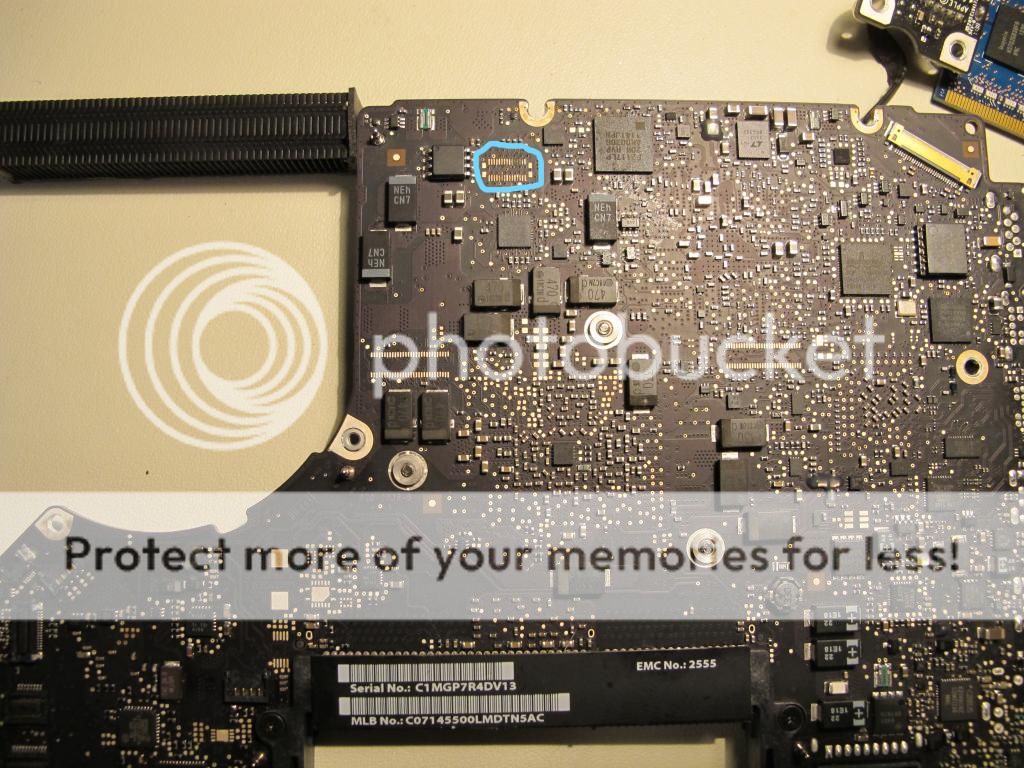

Checked logic board for damage (see pics). Cleaned all dust etc. No clear liquid damage but as you can see there is one spot that doesn't look so good!
So if it is the "burnt" looking spot how does that explain it working for 3 months straight as long as it was never shut down or the lid shut? And it came back to life briefly as well. Hasn't turned on once for me.

It does look like some kind of contaminant on the board. The pads circled in blue and the diodes (?) just south of the MAXIM chip and some other areas look like there was a spill of some sort. The flip side of the board with those cans also look like something is on the board. Circuits to the left of it don't look so good as well as one of the legs on the first coil (left). Maybe its just the photo or the lighting but are you fairly certain there is no spill damage ?
It was very dirty from dust, dog hair etc so it was hard to tell. I cleaned all the dust/dog hair etc and as far as I could tell there wasn't. There was one spot I questioned but it looked like some sticky residue from the adhesive or something.

Edit: I agreee it looks like something around that chip. Gonna take another look and see if it's just the pic.
Check about an inch or two all around your blue circle ( and the other side of the board) and look for ANY oxidized copper (green) on chips, circuits, traces, pads, if you see it then its likely a spill or water damage from heavy moisture (rain).
If its totally dead right now you cant really hurt it too much by cleaning it. :p
But I would GENTLY clean that blue circled group of pads and see if you get shiny clean copper. If you do then it could just be a non-corrosive build up or something. If you get brown or green or dull stuff then its corroded or oxidized.
Mac motherboards use so many tiny BGA/SMD chips that if they get a spill they will corrode or oxidize underneath and you cant tell whats going on without removing them first.
So if it was me I would try to determine if you have a decent spill with corrosion and if so I wouldn't put too much more time into it.

Cleaned that spot and one other I saw for sure. The one that is circled still shows some green.
It booted right up on the first try. Not expecting it to last but it's the first time since I got it yesterday.

I used lint free foam swabs and 99% isopropyl alcohol. Same as I use to clean thermal paste.
