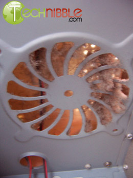

How to Clean the Inside of a Computer Case
Now we will focus on the power supply. Place the pen or pencil into the fan on the back of the computer (up near the top of the machine for most computers) and give it a good blast from outside of the computer, into the fan as shown in the photo below.
Cleaning the Power Supply Fan
Although the above step pushes dust into the power supply, it is the most effective way to clean the rear fan. Now, we are going to clean the inside grills of the power supply and get that dust back out. From inside the PC, clean the grills on the power supply until they are clean while stopping the fan from the outside.
Cleaning the Power Supply Grills
Many modern computers (especially gaming machines) also have another fan on their video card. If you do have a fan on your video card, stop the fan with something and spray it until its clean as you did with the other fans.
GPU Fan
Those are the most critical areas of your computer cleaned, you also may want to clean up any other parts of the computer that collect dust. In our example, the fan grill on the front of the case is also filled up with dust so I gave it a quick clean.
Cleaning the front Fan Grill
To finish up, I give the whole case a spray with the air which includes the motherboard, RAM, cables and the bottom of the case to blow away any dust it already had and dust that had fallen while we were cleaning the other parts.
Clean Computer Case
Finally, once your computer is clean, just close up the computer case in the reverse way you opened it.

  • Wow, that cpu fan looks extremely dirty! But very interesting step by step article. Some nice tips listed here.
