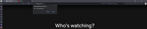

I have a workspace open where I do have the Netflix website open, and here's what I found, thanks to you:
I have no recollection of having granted this permission, as my browser level setting was "Ask," and is now "Block." But I had to have done so accidentally, as I've never had any site just turn them on without explicit consent.
I also would never have thought that the only control for this would be where it is, as this information is not enumerated in browser settings anywhere.
