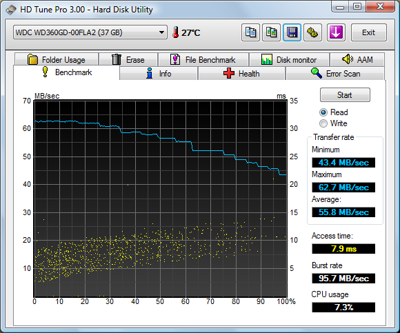

I use HDTune. Very good tool for benchmarking and error checking.
