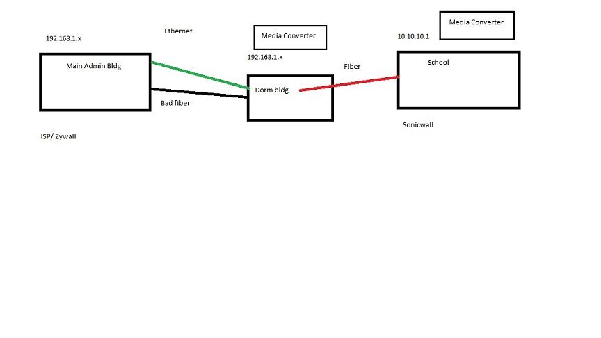

What switch? We need a full map of this setup.
ISP modem> Zywall 110 router> Zyxel switch> at this point everything on 192.168.0.x network, about 60 clients > fiber link via media converters > sonicwall > zyxel switch 10.10.10.x network. The 10.10.10.x network has the appearance of DNS issues, "page not found". Statically assigned IP and DNS on test computers. While pinging gateway upstream, we never lose a packet, or pinging 8.8.8.8 not one drop.

Well, technically I can, if I can find the fiber link from the first building to the middle building. but this scenario just went south on us late last week. Yesterday and today it's been rock solid. No one knows where the ethernet in one building comes from. This will affect users downstream as they need to be on the 192.168 subnet. I believe I may have found a good fiber run to terminate and that will solve these questions.
Yeold there is always a chance of loopback.... and the Nutgear lol was put in place to see if the sonicwall was the issue and it wasn't. The ISP should not be Natting as we are in bridged mode. If I can get that fiber found and terminated I will pull a second lan port off of the zywall and channelizes this mess. We need the sonicwall filtering for the proxy sites the kids go to.
