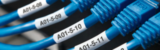

I use a Dymo Rhino 5200 - https://www.amazon.com/DYMO-Industrial-RHINO-Label-1755749/dp/B002M1DEM6
Labels are wrapped around the cable - works for many cable types and thicknesses. I used these Rhino printers back when I was an electrician, too.
Labels are vinyl and very tough... can withstand cable pulls, being wet, dipped in wire pulling lube, etc.
View attachment 12882View attachment 12883

Just old. Probably 6 or 7 years old by now... still works great. I would recommend the Dymo commercial labelers, so grab a newer model. :)
I like the fact that it prints in a thin label that can be read even when wrapped around the cable. I use a Brother P-Touch and making the labels like a "Flag" hanging off the cable is a terrible look.
