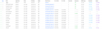

Anyone know why on a Gig I'm only getting 500 down using U6 Pro's ... I've heard changing the 5GHz channel to 80MHz?

WiFi 7 exists already because WiFi 6 is hot garbage. You have to be basically point blank with the WAP with no signal interference at all to get full speed.
Then you find out that most WIFI 6 interfaces don't have the guts to push that speed anyway.
We often have to force WiFi 6 WAPs to fall back to WiFi AC operating modes to stabilize networks due to all sorts of issues, and that reduces bandwidth further. Fortunately, anything beyond 200mbit is just a waste anyway given the way the US is cabled.

Well the worst speeds we saw before disconnection in the parking lot about 200 ft from the nearest AP was 100 down ... So it should be fine.
Oh yes, I don't mean to disparage your work it's well done. I'm just pointing out what you're seeing in terms of performance is normal.
Looks good...and looks familiar, did you have a post about that a year or two ago?
With the 5 radios....widening the channel will tend to get better speeds. However....the wider the channel, the less stable the connection is, and the less penetration/distance it has. Also, if you have multiple APs on a network...the wider the channel, the less non overlapping you have, thus the more overlapping you have. Thus...less performance.
For installs where I have more than say, 6 -ish APs....I will usually drop the 5 radio from default 40 wide down to 20 wide. This depends though...no always...but usually. Because, I prefer to install more APs...closer together, with TX power dialed down. So APs will tend to be have cells of coverage that will be close to each other. Easier to spread out my 5.0 radios when I have just 20 wide channels. Yes...just 20 wide is not as fast as default 40 wide...but it's more stable, usually no overlap, and better distance/penetration.
Kind of hard to say. Need more details. Like what is the end point? Where are you connecting? Is there any QoS? How/where are you getting the download speed from.
