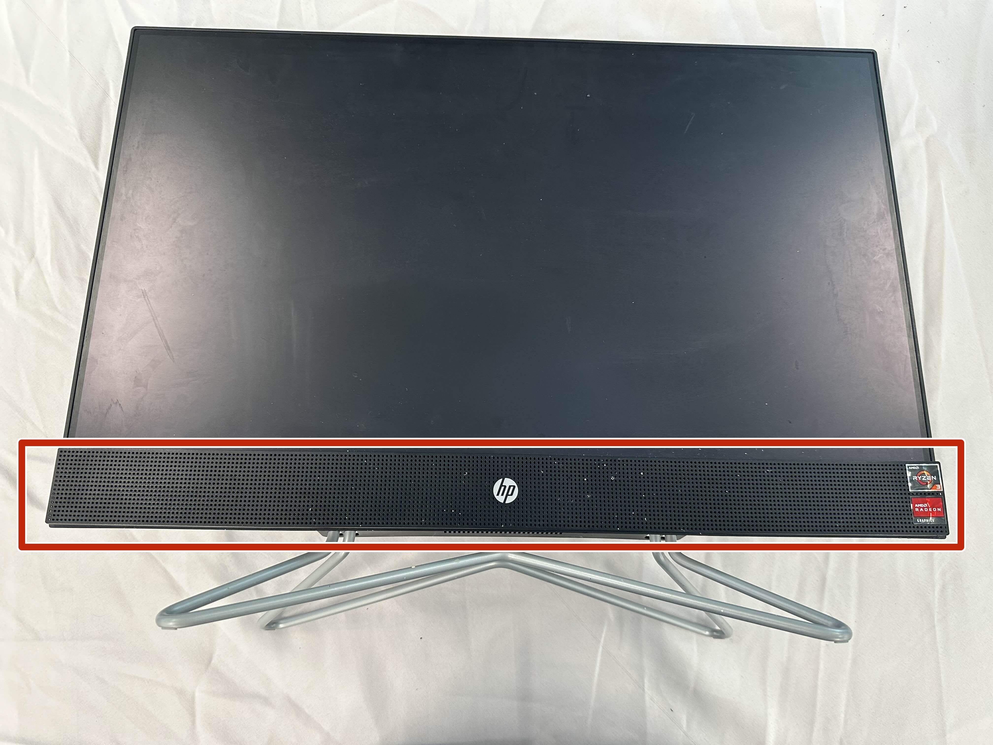

I watched 3 parts of it and the first one is replacing the stand. It's progressive after that. The bottom front panel over the speakers should just pop right off exposing the lower edges of the display.
Yeah that part came off fine...I still for the life of me can't figure out how the hell the screen comes out.
UPDATE: I decided to boot it on and I believe it may be a false positive after all with hp. That 90b error but the fan is clearly still working. I updated the bios and 2 reboots and no message at all. 3rd reboot message came up again...I had it on for several hours earlier and it was on fine with no issue so probably just gonna let it go after all. On these videos these guys make it look like the screen just comes right out easily after taking the screws out and maybe just a bit of prying but I felt like I'd break it so just kinda gave up on it.
I know you've said you moved on but I did find the tear down for the motherboard on iFixit. Posting here for ref. purposes.
Yeah that looks like the one. Thanks for posting it. I swear I didn't see any screws on the underneath part where the stand is...couldn't really move that plastic cover much since the stand was in the way...maybe something I didn't see who knows lol. I'll refer back to this guide if I ever see that machine again though for sure. Just got lucky and it worked out this time lol.
Hopefully you'll be quadruple lucky and never see any AIO ever again. LOL!!!!!
