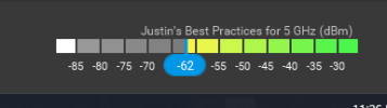

My house starts having problems around -65 dBm
Here is the Key/Ledged:
This is my second floor... The AP is actually in the upper right, that's where Ekahau thinks it is located (it's off by about 3'):
Dell laptops struggle at -55 dBm sometimes it seems!
