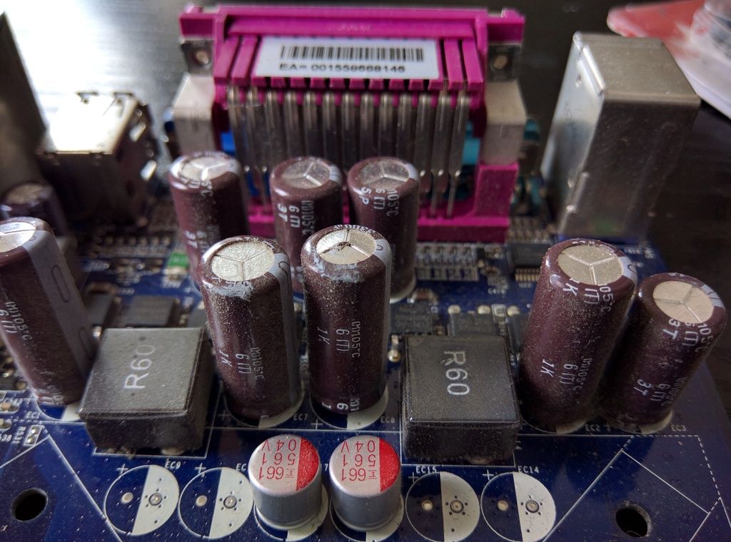

So in the little time I've spent with the system I've come to some findings, first off the 7600GS graphics card reached 98 Degrees Celcius running Unigine Valley for approximately half an hour with the side panel off, with the side panel on it *may* have achieved the 125 Degrees thermal shut off as the majority of the time he just watches tons of Netflix.

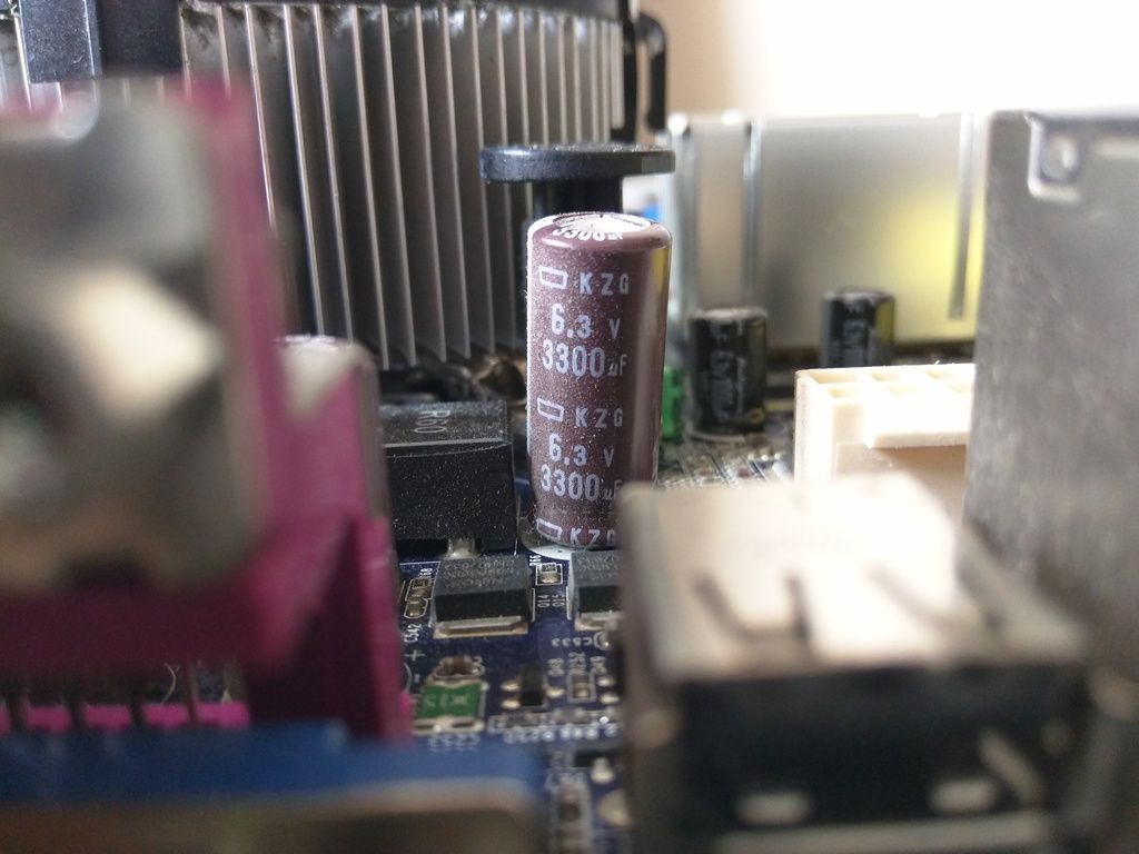

Secondly, I'm quite sure two capacitors next to the CPU are bulging at the top, I'm going to strip it down so I can see it at eye level to verify it is actually bulging, this could very well explain the "random" shut offs.
Using HWInfo I've monitored the 3, 5 and 12 volt rails under stress and (assuming the readings are right) they all regulate at around the correct voltage)
Good work. Check for those next to the PCI slots too, especially any that might be hidden by the graphics card. Also eyeball the caps on the graphics card itself, just in case.

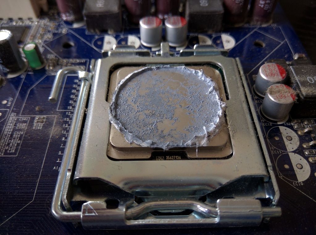

So I've stripped the PC and here are some photos of the offending capacitors.
And just thought I'd show this professionally applied thermal paste using the "Wall of China" method :p

Capacitors do not necessarily need to swell and crown at the top to be bad.
More than just the ones that are visibly leaking / crowing very well may be bad. Only
way to know for sure is to desolder one leg and test their ESR. Again on a system this
old i don't know that I'd bother but just know that replacing the swelled ones doesn't
mean the system is in tip top shape cap wise.
Secondly, even though that was a horrendous job at putting on the thermal paste.... chances
are it's long dried out since it was applied. Most often you'll find the OEM used a thermal pad
and they do not usually ever need to be replaced, at least not before the system should be.
I guess the long and short of this one is, even if they did it right.... it would still probably need
to be redone. But replacing it and doing it the right way can help. Too much thermal paste starts
to act like an insulator of heat and not a conductor, and that will shut down / kill a CPU real fast.

Thanks very much for your reply, in respects to the capacitors I have read quite a few contradicting points about them. One thing for certain is, a capacitor doesn't have to bulge to be broke and some have said a bulging capacitor (as you've stated) doesn't mean its broke. But then this whole techy talk got going then where some was saying you cant always test a capacitor because it may not run in parallel or something? Regardless they're bulging and one has definitely leaked so I'd say it needs to go :)
As for the graphics card its actually a passive cooling one, so it relies on the case circulation to cool it down. What I was surprised at (given it was a brand new pre built system) is that the only other fan is a little 80mm fan at the front.. The CPU fan is isolated with a fan surround to go straight out the side. But I have some IC Diamond and some remover and surface prep (from the Arctic Silver kit) so I'm expecting a good drop in temps. I mean, he's had it from new and for many many years, so it did run absolutely fine with the cooling it has now, with the exception of the thermal paste drying out so I think it will be interesting to see what a re paste could achieve for that GPU.
All in all, thanks for all your input and I may look into how to properly test capacitors as one day I may come across something a little more substantial than a 775 board where its worth replacing the capacitors. :)

A bulging or swollen capacitor is an imminent sign of failure. Don't trust it even if it appears to be working. I have a client whose mobo has had swollen caps for about a year. I explained to him what's coming his way and told him to keep good backups since he didn't want to replace the mobo.
