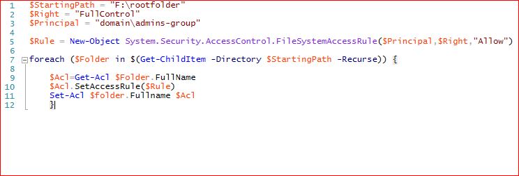

It shouldn't be a difficult script to throw together. I'm not a powershell expert but sounds like your looking at Get-ChildItem to filter the Scans subfolders from all your user folders, then doing a foreach loop and using Get-ACL and Set-ACL to update the ACL on the folder.
Quick Google, this is probably 90% there...
You would just need to modify Get-ChildItem command to filter out only the Scans subfolders and not every folder.
