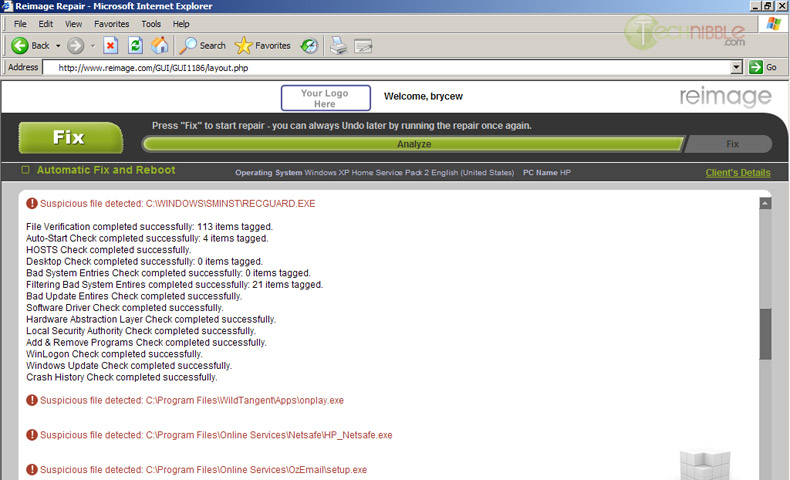

I logged in using my 7 day trial account and clicked “Start Repair”. The Reimage website analysed the computer which took about 5 minutes and displayed what it found:
Something I didn’t like about Reimage before was the fact that it didn’t really show you exactly what it was fixing. Now, it provides a full log and gives you the ability to uncheck things you don’t want it to fix.
Once I’m happy with what I want fixed I pressed the “Fix” button and let it go though the fixing process, this probably took around 15-20 minutes:

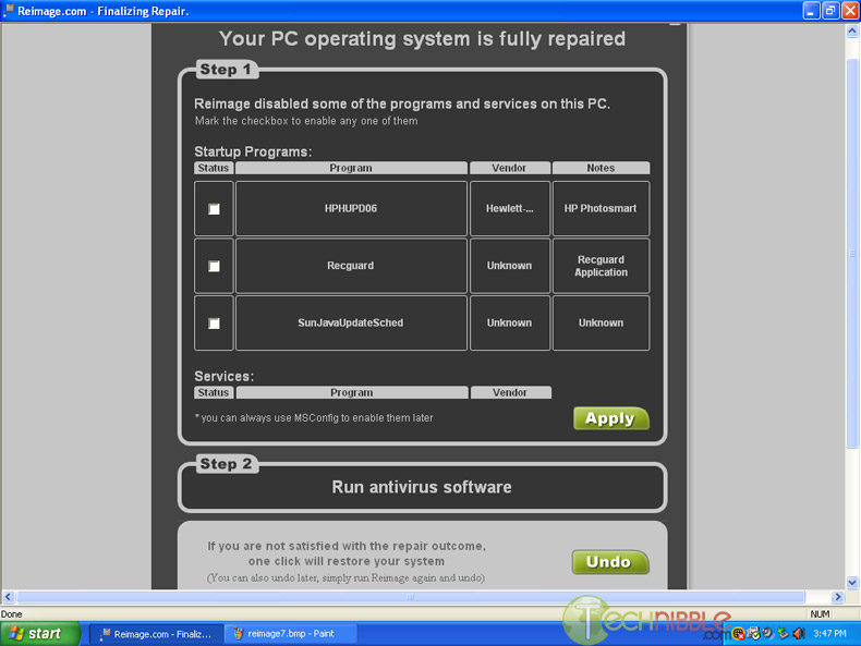

Once it completed the repair process it asked me to restart the computer and it powered up into Windows as normal. It seems to have successfully noticed that the NTLDR and ntdetect.com were missing and replaced them accordingly. Once I was fully into Windows I was presented with the following popup:
The guys at Reimage also wanted me to check out the Undo function if I wasn’t happy with the repair. In this case, I was fairly happy with the repair but I am going to test it for the sake of this review.
I pressed the Undo button, it went through its processes, the computer restarted and I was presented with this:
Yep, the undo function works.
