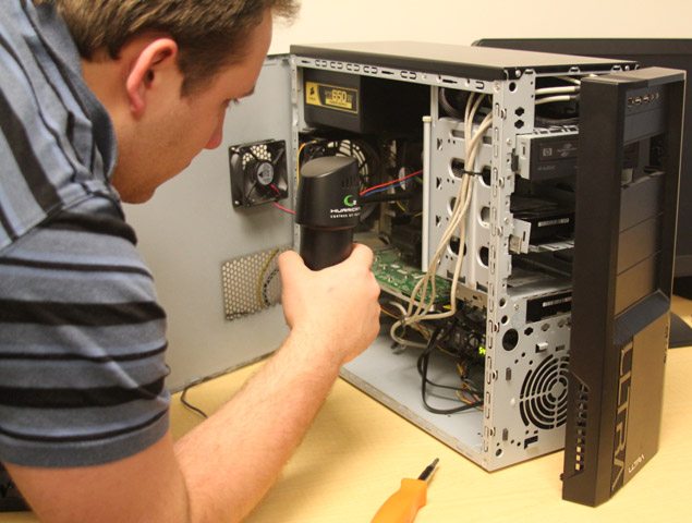

Derrick using the O2 Hurricane Computer Duster
It goes without saying that the Hurricane pushes dust like a pro. Just like canned air has a peak of strength beginning with the first minute or two of usage, the Hurricane behaves similarly. The stream of air is definitely strongest when the battery is fresh off charge, but the “usable life per charge” is still longer than what you get out of a single can of air. While I tend to see about 12-15 mins of airflow (confirmed by colleagues), your best airflow happens in about the first 10 mins or so. Still, this equates to a lot of air time.
