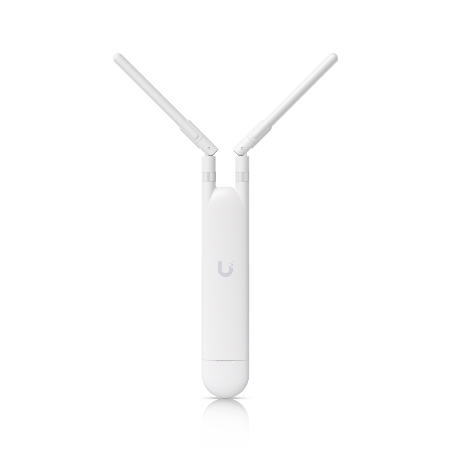

For the Outdoor Wifi I was thinking one of these attached to the side of the house? Are these even good anymore? They don't make an antenna based U6 AP yet.

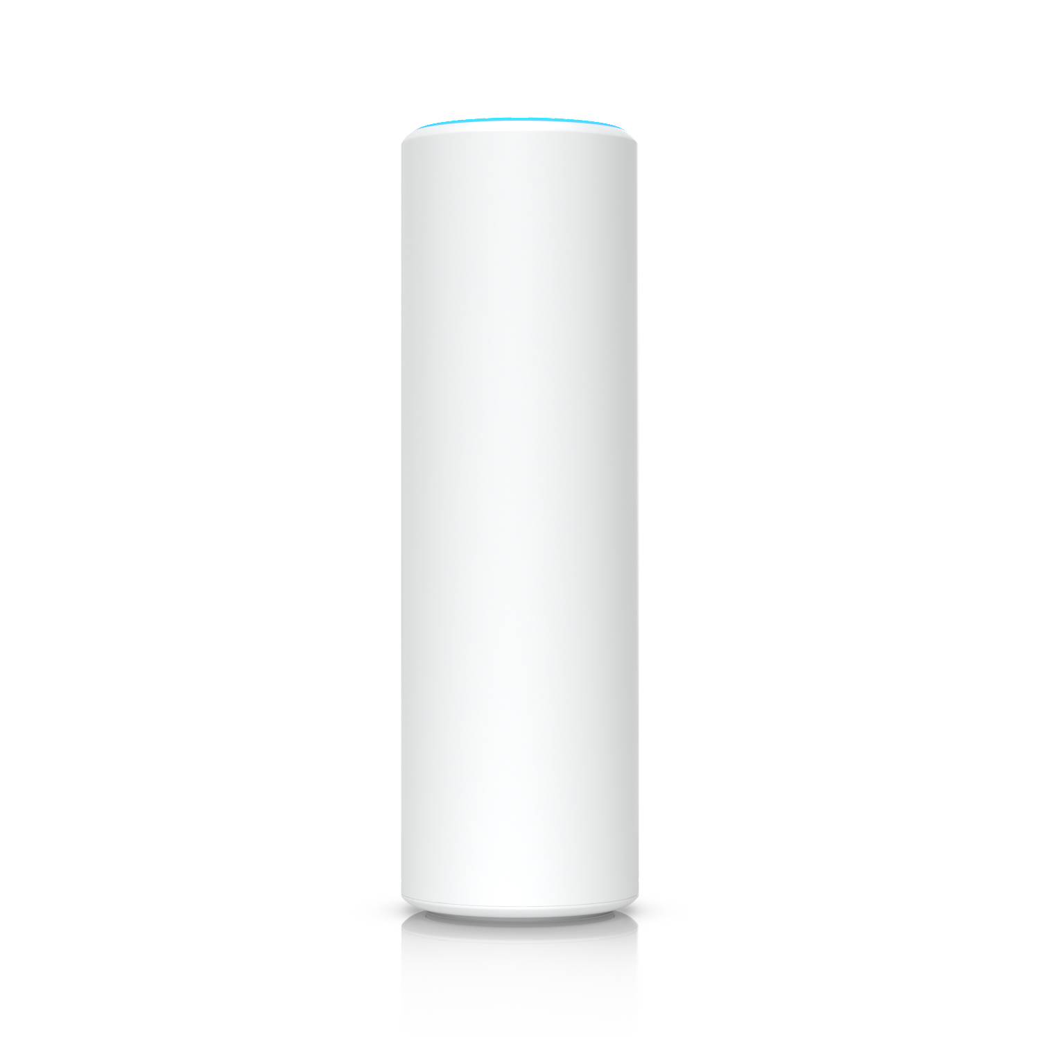

Or should I just stick another one of these on the side of his home on a pole?

I'd take the Mesh 6 over the old rabbit ear Mesh.
The Mesh Pro does have better range than either..esp in on the 2.4 radio..since the Pro has much larger antennas.
but the Mesh 6 is 4x4 MIMO...which is more future proof and performs better, handles more client connections, and if you have to mesh uplink...less impact.

Ok ... I'll probably just do a U6 Mesh Pole mount.
