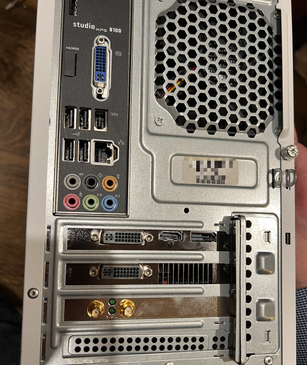

Had a frustrating evening trying to get this to work. For years customer has been running two monitors on this setup, each monitor with a DVI connection. The video card has two DVI ports, one HDMI port and one DisplayPort port.
Bought an LG display with HDMI inputs. When I connected it to the HDMI port along with the other two monitors running as they always did I only get two monitors to light up - the new LG on HDMI and one DVI connected monitor.

Here's a pic
So it looks like we've got DVI-I which includes analog, or not all digital. I didn't look at the pins on the actual cable. So if the cables have the "analog pins" I could just swap them for cables without the "analog pins" to make it a purely digital signal and thereby allow the use of a 3rd display?

So the card has DVI-I connectors so they are a little different setup. I was thinking the 6k series cards still have either dvi-d or dvi-a signals. Since the card ha -I it pushes both digital or analog but are on a separate channel or 'lane' from the HDMI and DP.
