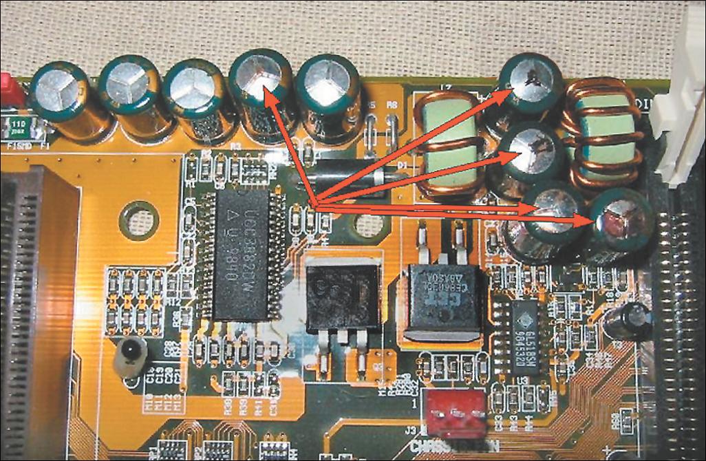

lol @ Bryce. Well i guess the video card slot is part of the mobo
Mate you should be looking for burned capacitors arround the video card slot. It can get pretty hot and dusty in there and if the 3D card fan gets clogged up with dust and stops things start to melt.
Good luck
