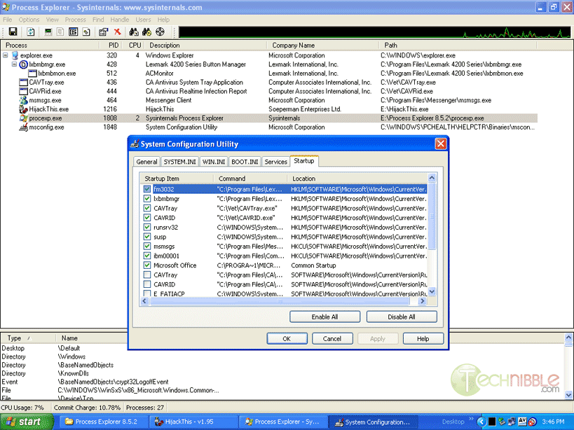

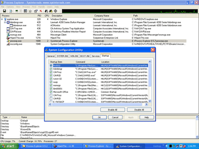

I then proceeded to look to see what was causing these processes to launch using a built in Windows tool called msconfig (Start > Run and type msconfig). Looking at the startup tab this usually allows you to deselect check boxes so that processes wont start on bootup. However this time it seems everything is grayed out.
View Full Size

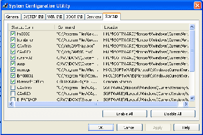

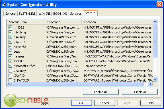

I suspected that these unknown processes were trying to stop me from removing them. So I went back to process explorer, killed the process and all the boxes in msconfig became enabled again and then unticked winsrv32 from loading at startup. It was at this point it was confirmed that these files were defiantly malicious and the cause of the original problem.
View Full Size
Using Process Explorer again, I found out where they were located on the harddrive which was C:\Windows\system32 and deleted the files winsrv32.exe and its child process repigsp.exe.
I restarted the computer to see if they continued to load at startup, opened up Process Explorer and there they were again, however winsrv32.exe was now called runsrv32.exe
This typically indicates that there are additional files somewhere on the computer which check to see of the existence of the malicious and if it has been removed (by a virus scanner or manually removed) it will regenerate it.Using Process Explorer again, I killed the process, unticked it in msconfig and went back to the System32 folder the file resided in.
